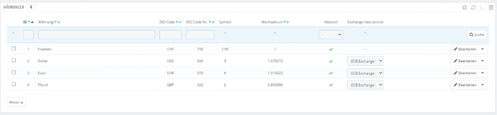

wakabayashi Posted December 23, 2022 Share Posted December 23, 2022 (edited) Looking a bit into earnings I checked out order_detail table. In my case, it seems that the column purchase_supplier_price is always calculated wrongly. This column should show the price, you need to pay if you reorder the product at the supplier. The currency is your default currency. That's where my issue comes from instead of $price/$currencyRate it does $price*currencyRate... Can you please check, if it's the same in yours? (only relevant when you set up supplier price in a different currency) It's also helpful, if you show me a screenshot of your currency rates: Edited December 23, 2022 by wakabayashi Link to comment Share on other sites More sharing options...

datakick Posted December 29, 2022 Share Posted December 29, 2022 Indeed, looks like a bug Link to comment Share on other sites More sharing options...

wakabayashi Posted January 6, 2023 Author Share Posted January 6, 2023 PR is out https://github.com/thirtybees/thirtybees/pull/1598 😎 Link to comment Share on other sites More sharing options...
