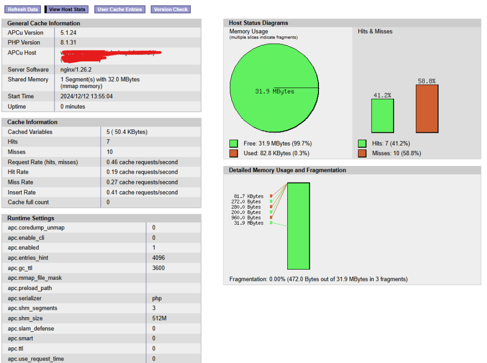

Thirty bees back office is loading very slow
wakabayashi replied to Madhosh's question in Technical help
Either you haven't show us the important results or your problem is something different. Aren't there any numbers in red with high "ms" or "Mb"? Cause from the screenshot you show, nothing is slow. -
