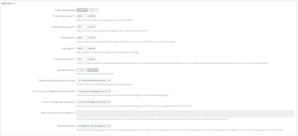

Warning: cloudflare enabled Speculation rules API
the.rampage.rado replied to datakick's topic in English
One more place where you forget to clean the cache from when troubleshooting. 😄 😄 😄 Just joking. Of course if your site has thousands of visitors a day it will help, also it is useful as a first measure if somebody is trying to bring your site down. If your host is fast and your cache is working you might not see a big improvement in speed but for big sites it's a must. -
So check your thirty bees settings then. Be sure that the app is working, yes, there are unfortunately many ways you can misconfigure it (I had similar issues a while back and it was totally my fault).
Misconfiguration of your app or your server is not thirty bees' fault. I would strongly suggest triple checking your setup and settings and if you can't find the issue search for paid support.
