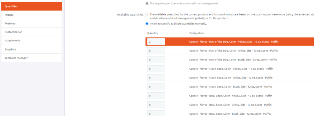

If you sell different types of those (different sizes, different bases, etc.) I would configure it as follows: Attributes: Wood/base color: wood1; wood2; wood3; wood4 Mane: mane1; mane 2 Unicorn: yes, please; just normal horse Create a normal product, put base price (the lowest of all combinations if you have differences in those). Go to Combinations - use Product Combination generator Select and add all applicable attributes from all applicable attribute groups If you have some price increases for certain attribute put in the respective field to the right. Click 'Generate these combinations'. You have 16 combinations for this product. If you have sizes of this product you can make another product or add it here and also put the differences in prices for it (you will have to adjust the price increases and balance them if the different woods also have price differences).
