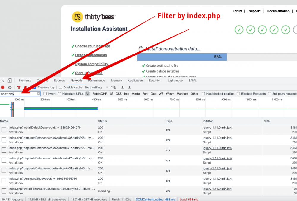

  21. The fact that the database is located on different server connected by stunnel is unrelated. This is just a red herring. Let me reiterate what we know: during installation, database is created from scratch as is empty the theme is installed when index.php?installTheme=true request is processed by php server. This is the only place in install process that calls the theme install method the error is throws only if theme is already installed -- the record in database exists The only explanation for this error to occur is that the index.php?installTheme=true request was processed twice by your php server. If you browser does not send the request twice, then there must be some other component in your infrastructure that duplicates / repeat this ajax call. For example, there could be a load balancer or proxy server. Maybe proxy server is misconfigured, and re-send the request to your php server if the response is not received promptly (this might actually explain why it works when db and php are on the same server. Communication via stunnel is bound to have higher latency) Look into your php server access_log to verify how many times the installTheme request was received.
  22. Not possible. Just... no. The only way this could happen is if your browser sent two ajax requests to install theme. That's very unlikely. Very, very unlikely. Unfortunately it's possible, but only if you have some very weird caching browser extension, adblocker, etc. Or maybe some server redirection.... who knows. Look into browser console, Network tab, and see what requests are send during installation. There should be only one request with installTheme=true
