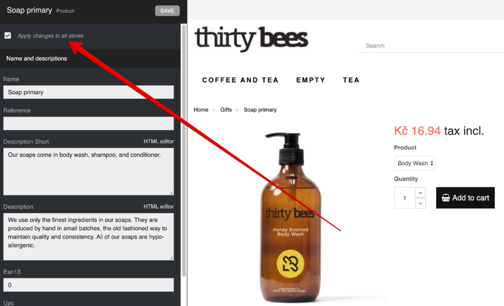

I don't really know how to generate multiple invoices for one order. I just see there's a support for this in the code. Also, in back office order edit form there is some support for this, for example when adding discount: But it's totally possible this is just remnants of some old functionality that was dropped from ps/tb
