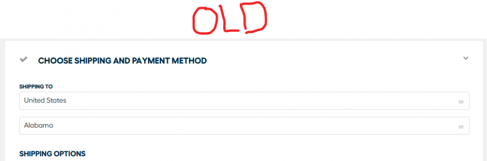

  7. Hi, Now that holiday season is passed, I'm testing this out. First thing I notice is that the state/province selector has disappeared in the new 0.9 version. We are using that field to display correct shipping options to customers in the U.S. in an order flow that makes sense. It's also removed in the shipping address tab. I've validated via reinstall that it's included in 0.8 but not 0.9 This must be a bug.

  10. I've been trying to reproduce it as well and haven't figured out the sequence. All I know is that it is happening far two often. I had two of them already this week. Being a U.S. company that sells into Canada, we require state or province. In the U.S., the incorrect injected shipping customer is always in the state of Alabama. We had our first Canadian issue this week as well and the injected shipping customer was based in Ottawa. I'm unable to tell if it is showing the customer the wrong information ahead of them processing the order. I have confirmed that the wrong shipping information shows on their order documents and within the system after being processed. Also, the link of the incorrect shipping information doesn't ever link to the ordering customer's record. If we catch it ahead of shipping, I can switch the order's shipping information to the ordering customers correct address, and then that incorrect address that previously was linked is no longer linked to the order or the customer anywhere that I can see at the database level.
  11. Did you ever produce a module update that addresses this issue. I've dealt with the same problem for multiple years now. It doesn't happen often, but it definitely happens exactly as @Herrosik explained. Then our fulfillment team ships to the wrong address that was injected and it costs us on every order to fix and replace. It happens enough that we're considering leaving TB because the service costs associated with fixing orders are negating value gained by using the software. @datakick, can you advise if and you we can resolve this issue?
