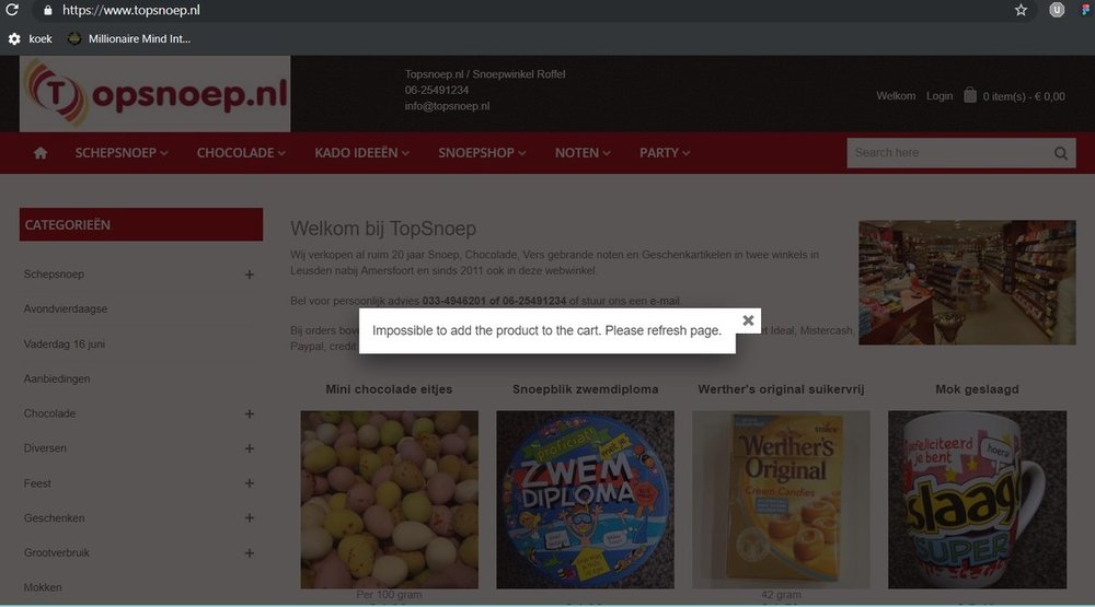

  2. That makes it a bit more difficult. You can look in the log directory of your webshop. If that doesn't work you can look in the javascript console. To do that you should enable debug mode, open the javascript console and follow what I have described here to see what the error is about.
  3. I am not sure what you mean with "the modules list at the bottom of this page are all highlighted in red? " The javascript error is in Jquery and I can't find what the real origin is. My prime suspect - for lack of better - is your highdpi/highres code. Could you try what happens when you switch that off (don't forget to clean the cache after you do that)?
  4. Can you look in the error log of your server to see what this 500 error was about?

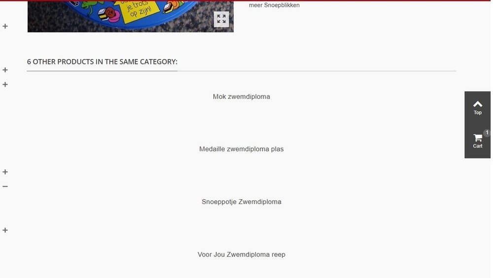

  6. Could you disable the smart cache for javascript and some other optimizations in Advanced settings->Performance? There are some javascript errors and with the optimizations it is not possible to determine which files cause them. In addition you might consider switching off pretty urls. The file system and the database for images are exactly the same for Prestashop and Thirty Bees. So I would consider the fact that most product images did not make the migration a rather serious problem. It is a common problem that images need to be regenerated after a migration or a change of theme. But in your shop the images I checked are really missing. Have also a look at your shops with Prestools. As it works directly on the database it will provide a good indication to what extent your problems are in the database and to what extent in the software and shop settings.

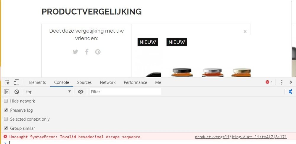

  15. I tried changing _PS_ROOT_DIR_ and _PS_CORE_DIR_. It doesn't work. On the backoffice you see it immediately as you get the typical "without-css" unformatted page display. The front office seems to work at first sight. But when you check for javascript errors you see problems there too. There are a few php commands - such as realpath - that produce the backslashes and they are used widely in the software. It would be a major effort to check them all out for causing problems (for example by subtracting _PS_ROOT_DIR_ ). Also - even if you did this you might find problems with modules and other third party software. Besides that it would harm the PS 1.6 compatibility.
  16. The CoreUpdater has some Windows problems that as far as I know still hasn't been fixed in the official distribution. You can find here what you must change:
  17. Try to install a fresh TB 1.10 with the Niara theme and you will see dead image links in the new products section. That module is looking for medium_default and that is not available as only Niara image formats are generated. I doubt whether the PageNotFoundController can be a good solution. Modules expects a certain format and when they receive another format their layout can become seriously damaged.

  21. The error may be prior. I did a little test on my Xampp and got an error already on the comparison page before I deleted anything (I have compacted the image a bit to make it less wide): When click the link to the error file I get this: I assume that this sharing image will be used as basedir and that its backslashes will be processed as escapes in javascript and cause problems.
