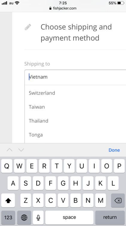

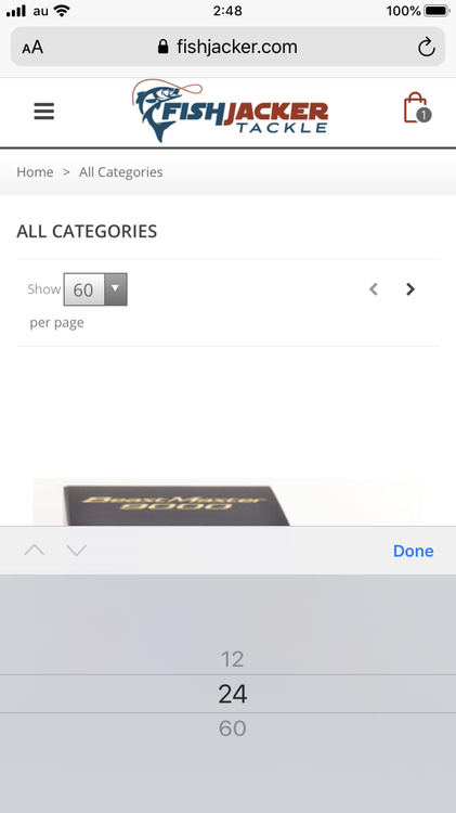

dynambee Posted October 9, 2019 Posted October 9, 2019 11 hours ago, datakick said: This is not governed by chex module. I can refer you to this article about mobile zoom I stumbled across an example that better illustrates what I was suggesting for mobile list selection, at least on iOS (I don't have a modern Android phone to test with, unfortunately). When clicking on the country list in Chex it presents a desktop-style drop-down list, like this: However the default (again on iOS) for list selection is this, as shown from the "products per page" selector: I don't know how difficult a change this is but it would definitely make the checkout experience on mobile to be a more mobile-like experience.

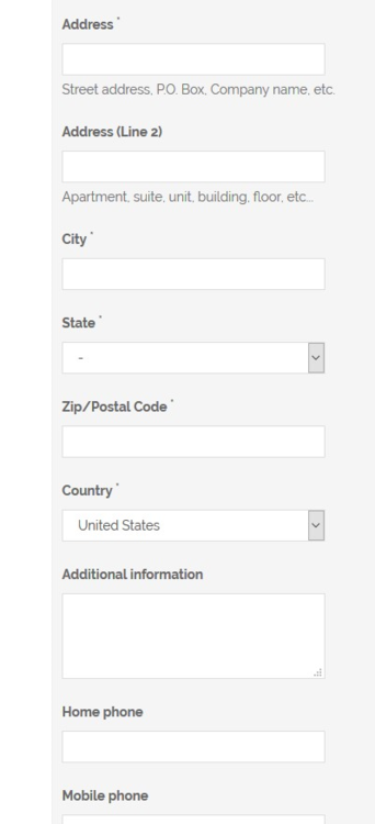

dynambee Posted October 9, 2019 Posted October 9, 2019 I've been looking at the state selection issue and guest checkout process in a bit more detail, and I think there is a problem here. The way Chex is set up currently, only countries that have states defined in the TB system (in the tb_state table, to be specific) have the option to select a state, and the state is supposed to be chosen to get a shipping estimate. There are two issues with this, IMO: As I wrote about previously, there are going to be quite a few situations where the state is not necessary to get a shipping estimate. This is true for most people who ship internationally, and it would be true even for domestic shippers who offer flat rating shipping. It would be nice to allow the shop owner to decide if the State field appears together with the Country field at the start of the checkout process. On the flip side, if the customer is going through Guest Checkout and manually entering their address, there is no State field in the address area. There are many countries that have states, provinces, or similar that do not have listings in the TB database. Malaysia is one. South Korea is another (though it is not always used that way). In Switzerland a canton is sometimes used in addresses, but not always. Basically the State field should always be shown in the Guest address creation area. For countries that have states defined it should be a drop-down list, and for countries that do not have states defined it should be an optional text entry field. This is the same way TB treats address creation for Guest Checkout, and the same way users with accounts create addresses. I'd also add that for some users it will be confusing to not have a Country option when they are creating a Guest Checkout address. As shop owners and developers we understand what is going on intuitively but to a shopper who is perhaps not all that technically oriented they are going to expect to see a Country field when creating their shipping address. Ideally the Country field (and the State field in case of a drop-down) should default to whatever they chose earlier in the checkout process but from a UI / UX perspective they should both be shown, in my opinion.
datakick Posted October 10, 2019 Author Posted October 10, 2019 8 hours ago, dynambee said: As I wrote about previously, there are going to be quite a few situations where the state is not necessary to get a shipping estimate. This is true for most people who ship internationally, and it would be true even for domestic shippers who offer flat rating shipping. It would be nice to allow the shop owner to decide if the State field appears together with the Country field at the start of the checkout process. This is quite complicated area. Basically, the ideal solution would be to request only those information that actually participate on shipping costs. In standard thirtybees, this is country+state. But some of my clients have custom modules that modifies this -- for example, one of them has different shipping rates per postcode. And as you noticed, you can configure your thirtybees as you wish - some merchants might have flat rate for the whole country, and some even offer flat rate worldwide. In these case we don't really need to ask for shipping country / state at all... My module can't decide this automatically. So, the ultimate solution will be to allow merchants decide which info are necessary to be entered upfront in order to calculate shipping. I have this in my backlog. But due to the complexity of this task don't expect it anytime soon 8 hours ago, dynambee said: for some users it will be confusing to not have a Country option when they are creating a Guest Checkout address. Again, this is already in my backlog. It's not particularly hard to implement, I just need to figure out a proper way to do this. My initial plan for this module was to show the final price as soon as possible (in the first step of the checkout), and this price would not change in subsequent form filling. But this ability to enter country/state will change that. But it's probably not a big deal -- if the country/state will be prepopulated, most customers will not change it. 1

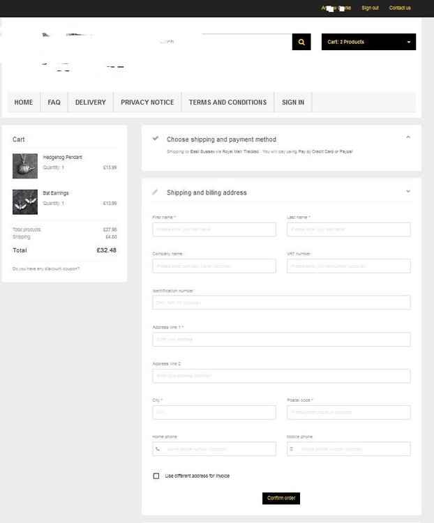

AndyC Posted October 10, 2019 Posted October 10, 2019 Please can I ask a general question ... I've got the full module installed TB 1.1.0 Chex 0.5.0 If I log in with my facebook account (that has my address registered under account) if I then checkout I am asked to fill out my address again ... If I do this on my Knowband website it doesn't ask me to fill out my address again.. Although if I make a account (via log in) it seems to work fine
dynambee Posted October 10, 2019 Posted October 10, 2019 Could you open the "Shipping and billing address" section and post another screenshot? You can blank out your address details, but since that's where the situation is happening it would be good to see that part of the screen.
AndyC Posted October 10, 2019 Posted October 10, 2019 Do you mean at checkout ..It's just blank ..Hop you can see it as I had to make it quite small to fit into 1 screenshot
dynambee Posted October 10, 2019 Posted October 10, 2019 1 minute ago, AndyC said: Do you mean at checkout ..It's just blank .. I've been doing a LOT of testing with Chex recently as I really want to use it on my upcoming sites. Looking at your screenshot it looks like you have selected "East Sussex" as the destination country? Have you redefined countries to be something besides countries to make Chex work better for your situation? My testing experience has been that if the saved address' country does not match the country you have selected in Chex's drop-down list to get a shipping price then the saved address will not be presented as a shipping option. So my best guess would be that the saved address has United Kingdom (or some other country) set as the country but the drop-down list of countries has East Sussex selected. Is that correct?
AndyC Posted October 10, 2019 Posted October 10, 2019 Oh bugger .. I see your point .. I am East Sussex with facebook .. I had West Sussex as my county .. So they didn't match .. Now that I have corrected on my account it is fine at checkout ...oops me at fault again 1

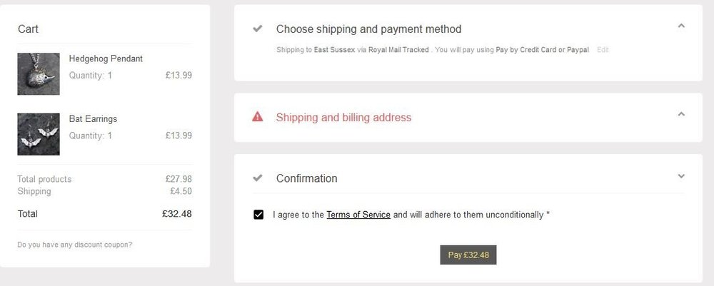

dynambee Posted October 10, 2019 Posted October 10, 2019 I love Chex, it is very similar to what I would have developed myself if I had the ability to make a one page checkout myself (which I don't, although I am a programmer.) However I don't think this is really your fault. The module should give an error in the "shipping & billing address" section when there are saved addresses available but they don't match the country selected for shipping. Something like, "Selected shipping destination does not match any currently saved addresses." This sort of mismatch is certainly possible to happen and customers may not notice what is going on. Personally during my testing I didn't notice what was going on, and during your testing you didn't notice what was going on. It was only by chance that I figured it out, and only yesterday! During the address creation process there is no place to select State or Country, and no display of which State or Country has been chosen. If a customer has been trying different destinations out of curiosity to see what different shipping costs would be (and this is totally something I would do myself...) they could end up leaving it on the wrong country and then creating a shipping address to the wrong country. Chex works differently to most other checkout modules, and that is what makes it so awesome. On the flip side though it also means that it works differently to what customers are used to using, and because of that it needs to be extra clear about what is going on to avoid mistakes & confusion. That's my opinion, anyway. 1
AndyC Posted October 10, 2019 Posted October 10, 2019 (edited) I too actually like Chex , sadly I bought Knowband checkout first as Datakick had only just started developing it.. But yes it does need a error message then if even just a line in red if something is amiss.. But thanks for managing to point me in the right direction.. I've only just upgraded tonight... Am loving the way you can change details and add new items Edited October 10, 2019 by AndyC
