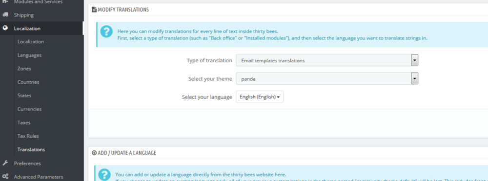

colorful-ant Posted March 8, 2019 Posted March 8, 2019 Copy the mail files into the correct folder and translate it. example from ... / themes / yourtheme / mails / en or ... / mails / en to ... / themes / yourtheme / mails / es

EduCreativos Posted March 8, 2019 Author Posted March 8, 2019 Excuseme but I don't Know, Where I can translate it? In Translation and what module? Thanks
colorful-ant Posted March 8, 2019 Posted March 8, 2019 i hope the image helps. i also had a small problem with mails through a module, because it was not translated, no emails were sent.
