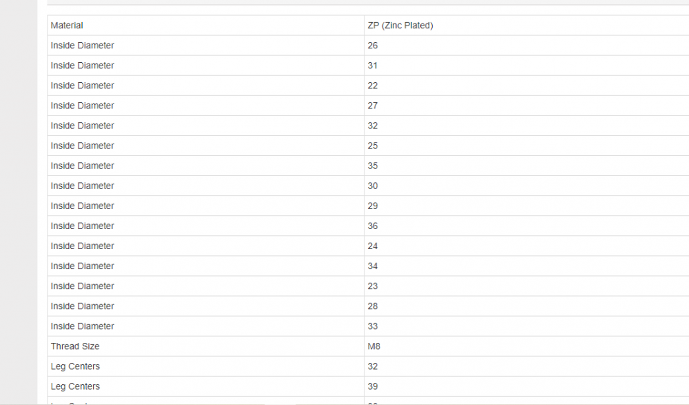

First thoughts: Looking good - a great start 1) It does not interfere with the multiple feature module i have 2) works with Advanced search 4 and block layered navigation 3) I did not need to change the table indiex so guess the module I have had already done that 4) Works with store manager Suggestions, while I understand you do not want to 'copy' the multiple features module perhaps what it does will help tidy things up 1) Do you really need to indicate which features are allowed multiple features? If all were allowed then there would be no need for extra columns in the features table. So make it so all are multiple value then just not use when you don't need to for each individual feature 2) We have lots of features so finding them is tricky. Lot's of scroll and ctrl / select to choose. Not easy to see what is selected: The current module has a search feature (narrows down the list as you type and also shows the list of currently selected ones to the side 3) With lots of features the front looks not good Where as the current module sepearates the multiple features with a comma (Seperator symbol can be changed in module) rather than line break making it much easier to see 4) Possibly need a sort by position rather than numerical / alpabetical / index Overall a great start - well done. Now all we need is Block Layered Navigation to allow multiple selection and perhaps ranges (sliders) and all will be near perfect 😉

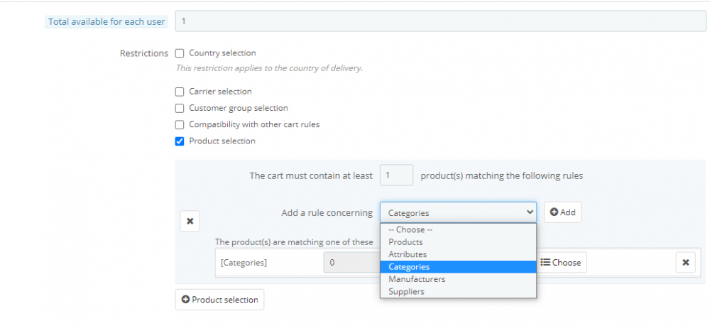

Is it possible to exclude a category from discount coupon?
haylau replied to Alex Hansen's topic in English
I think so. Never done it, but this looks like it is possible . After choosing categories you get a list of categories to include so jsut include all except the one you want to leave out -

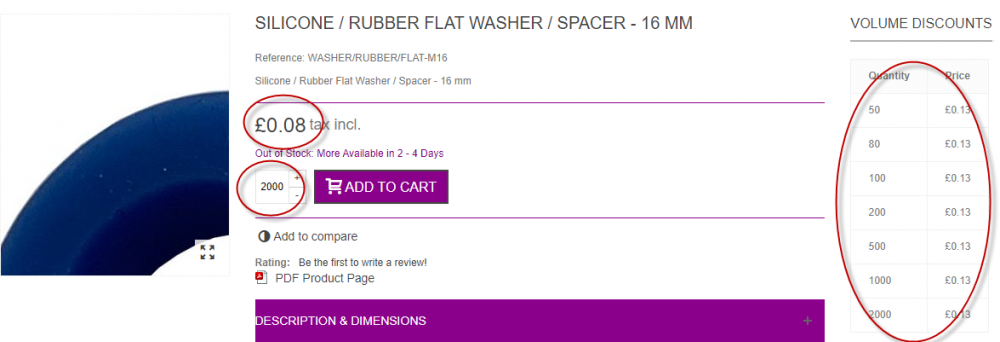

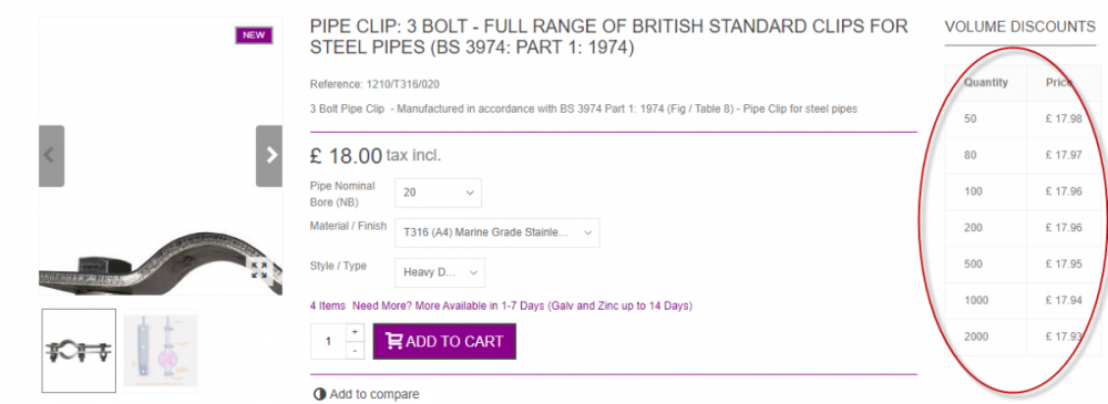

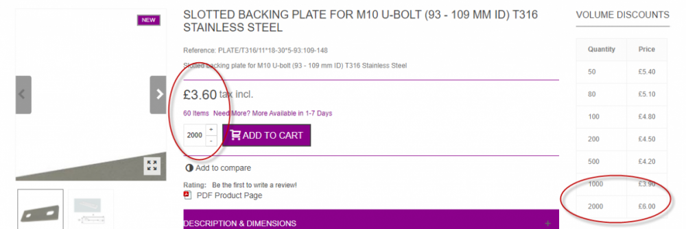

So, I managed to move the block of code in products.tpl - and it looks great Now, there is a calculation issue. This is not to do with moving the code. I have tried leaving the code where it should be. Not to do with the theme because I have tried the code directly from niara. It ust be an inherant bug I have changed the table to show prices rather than discount level Display discounted price set to yes in preferences > Products So, the calculations are all over the place. som times totally wrong, sometimes partially wrong. It is not to do with browsers or caches Some examples This one shows price is calculated correctly on the main buy box, but the volumes discounts not calcualted at all This one shows most of the volume discounts are correct, just not the last one And this one shows some calculations but they are all wrong And just for reference all products have got these discounts associated with them I will have to leave it showing % for now, but this is weird. At first I thought it may just be to do with rounding on small values because I was looking at low value products, but that last one shows that is not the case. Any clues?

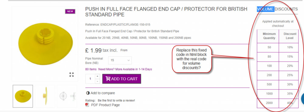

I have created the github bug report https://github.com/thirtybees/thirtybees/issues/1300 I have added an html block to the product secondary column to display a static volume discount display Looks OK, but is fixed. Should it be possible to add the relevant code from products.tpl to the html box to display and automatic table in the html block? That way I can display the actual prices. I have tried but it just displays code. Possible?

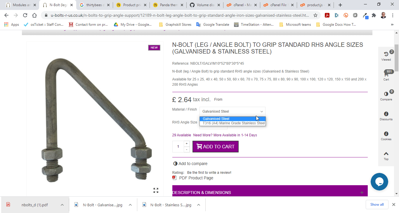

Thanks for the reply. Pretty certain I am doing it correctly, though I am no expert. I have tried removing the code & commenting the code in product.tpl Also tried adding css to custom.css sections Also tried directly from the brower Inspect. If someone wants to try, discounts start at 50 : https://u-bolts-r-us.co.uk/u-bolts-with-convex-base-to-minimise-crevice-corrosion/12123-u-bolt-for-40-nb-483-od-pipe-t316-stainless-steel-with-convex-base-to-minimise-crevice-corrosion-5055624431605.html#.YFOG_q-gLIU) Always the same Also tried on another installation with community theme and that is also the same And lastly tried a free module from presto-chano to move it to below the price. The module did not display properly but the effect was the same. Weird I was going to test the demo but demo.front does not seem to have any volume discounts set, and demo.back is, well, broken To be honest I would be happy to leave it on if i could move it into a proper tab, or even better in product secondary column, to the right of the current price / buy now button
OK, worked out the cause. In products.tpl I remove a section because I do not want to display the volume discounts table. I want the discounts to work, just do not want to display the big table So i comment out this code but that stops the functionality. I have tried using display:none but again that stops the functionaility So looking for clues how to remove / hide the table but retain the functionality Code I removed (panda theme, but I suspect this may be more generic): {if !$content_only} {if (isset($quantity_discounts) && count($quantity_discounts) > 0)} <!-- quantity discount --> <section id="product-volume-discounts" class="block section"> <h3 class="title_block "><span>{l s='Volume discounts'}</span></h3> <div id="quantityDiscount"> <table class="std table-product-discounts"> <thead> <tr> <th>{l s='Quantity'}</th> <th>{if $display_discount_price}{l s='Price'}{else}{l s='Discount'}{/if}</th> <th>{l s='You Save'}</th> </tr> </thead> <tbody> {foreach from=$quantity_discounts item='quantity_discount' name='quantity_discounts'} {if !$quantity_discount.base_price}{$quantity_discount.base_price=$productPriceWithoutReduction}{/if} {if $quantity_discount.price >= 0 || $quantity_discount.reduction_type == 'amount'} {$realDiscountPrice=$quantity_discount.base_price|floatval-$quantity_discount.real_value|floatval} {else} {$realDiscountPrice=$quantity_discount.base_price|floatval*(1 - $quantity_discount.reduction)|floatval} {/if} <tr class="quantityDiscount_{$quantity_discount.id_product_attribute}" data-real-discount-value="{convertPrice price = $realDiscountPrice}" data-discount-type="{$quantity_discount.reduction_type}" data-discount="{$quantity_discount.real_value|floatval}" data-discount-quantity="{$quantity_discount.quantity|intval}"> <td> {$quantity_discount.quantity|intval} </td> <td> {if $quantity_discount.price >= 0 || $quantity_discount.reduction_type == 'amount'} {if $display_discount_price} {if $quantity_discount.reduction_tax == 0 && !$quantity_discount.price} {convertPrice price = $productPriceWithoutReduction|floatval-($productPriceWithoutReduction*$quantity_discount.reduction_with_tax)|floatval} {else} {convertPrice price=$productPriceWithoutReduction|floatval-$quantity_discount.real_value|floatval} {/if} {else} {convertPrice price=$quantity_discount.real_value|floatval} {/if} {else} {if $display_discount_price} {if $quantity_discount.reduction_tax == 0} {convertPrice price = $productPriceWithoutReduction|floatval-($productPriceWithoutReduction*$quantity_discount.reduction_with_tax)|floatval} {else} {convertPrice price = $productPriceWithoutReduction|floatval-($productPriceWithoutReduction*$quantity_discount.reduction)|floatval} {/if} {else} {$quantity_discount.real_value|floatval}% {/if} {/if} </td> <td> <span>{l s='Up to'}</span> {if $quantity_discount.price >= 0 || $quantity_discount.reduction_type == 'amount'} {$discountPrice=$productPriceWithoutReduction|floatval-$quantity_discount.real_value|floatval} {else} {$discountPrice=$productPriceWithoutReduction|floatval-($productPriceWithoutReduction*$quantity_discount.reduction)|floatval} {/if} {$discountPrice=$discountPrice * $quantity_discount.quantity} {$qtyProductPrice=$productPriceWithoutReduction|floatval * $quantity_discount.quantity} {convertPrice price=$qtyProductPrice - $discountPrice} </td> </tr> {/foreach} </tbody> </table> </div> </section> {/if}

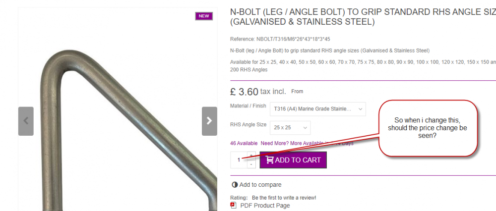

Not sure why I have not spotted this before really. Perhaps because I am now playing with combinations. We have various tiers of quantity discounts, 10% off for 50, 20% off for 100 etc. On the product page, when I change combinations the price also changes - great, but when I type or select a quantity the price is not updated. It is fine once added to the cart (BTW when I tried to upload an animated gif but it would not let me, gave a -200 error, but worked anyway) So my question is, on the product page should I expect the price to be updated to apply quantity discounts? If the answer is yes, then i need to work out why it isnt (ideas? If the answer is no, then is there a module / code hack I can use?
