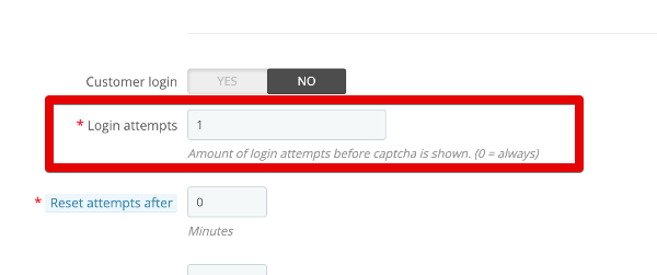

I've just went over the code and found one bug. If the Login attempts is set to non-zero number, the validation for Contact controller is always skipped. So make sure it's zero until this bug is fixed.

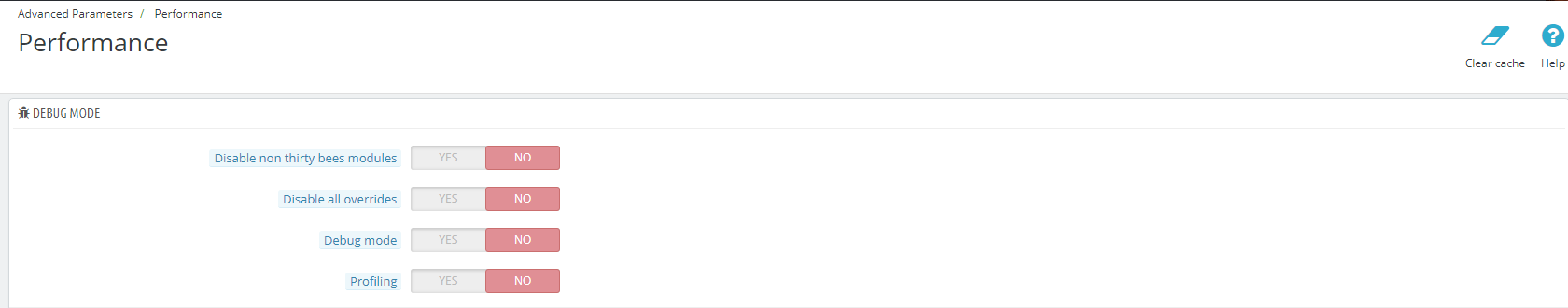

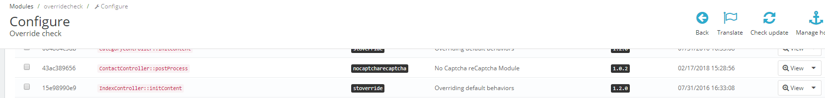

It does perform backend validation, but it depends on override. Please ensure that the override for ContactController is installed (you can use overridecheck module to do this), and that you do not have override disabled in settings.
Nice - I didn't know this override check module, but looks like the nocaptcharrecaptcha override is active: 0_1545841138874_46c8cd22-6807-4013-a216-3f0740fedc18-image.png Also override is not disabled in the settings: 0_1545841207384_3d1af6b1-8ad8-4b60-955f-258aa39e29b5-image.png
Thank you @datakick - you are awesome as always!!! Will check and report back asap. I can report one more bug with 1.1.0 but it's not that important - it does not remove it's front override when uninstalling. One must manually delete it in order to install another module.
EDIT: Yes, it's working just as expected that way!!! Happy as hell!
@datakick - My login attempts is already set to zero, so this doesn't help me. @the-rampage-rado - Which free PrestaShop module did you install instead of the Thirty Bees module? I use the Panda theme: https://www.sunnytoo.com/product/panda-creative-responsive-prestashop-theme. @SLiCK_303 - did you get your spam problem fixed?

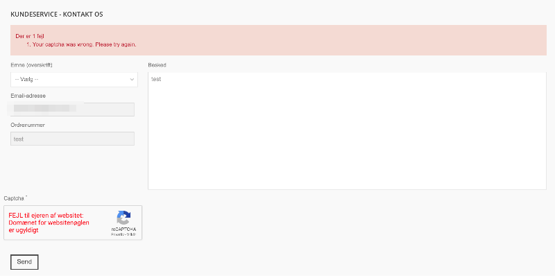

@elund it seems to me that the captcha is working on your site. I've just performed simulated attack -- tried to submit new message via curl, with invalid captcha validation token. My attack attempt was successfully intercepted by the captcha module, see the screenshot.
How many spams are you receiving?
PS: from your screenshot it's apparent that you are not using latest version of the module. Maybe that would help
