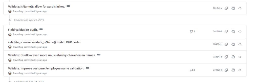

basix101 Posted April 22, 2019 Posted April 22, 2019 (edited) I have the same unwanted Customer Registrations from the same spammer. I'm not a coder, just a copy and paster! Can you please tell me which is the correct code to alter as I am confused? 1: https://github.com/thirtybees/thirtybees/commit/7ad147d991861e498e586f4dfc8ad1ff 2: https://github.com/thirtybees/thirtybees/commit/c733d5360d5292c12bb6a899748d9094bc608e05 3: https://github.com/thirtybees/thirtybees/commit/f04f1ded917b702465b2da6adfb7d573fdb974ad Thank you Edited April 22, 2019 by basix101 found another github link

Guest Posted April 23, 2019 Posted April 23, 2019 (edited) 19 hours ago, DRMasterChief said: Yep, but in all 3 Github links is the same file which should be changed, but with different changes (classes/Validate.php) , think this is very strange for some people. Or am i wrong, hopefully not 🙂 regarding i will do this changes in 1-2 days. btw. will there be an update for this (i think it will be included in the next, but not sure when this will come)? I was getting hit with these too. Fix was really easy to implement. Thanks a lot for releasing this so quickly. You do all 3 of these. Do this one first:https://github.com/thirtybees/thirtybees/commit/c733d5360d5292c12bb6a899748d9094bc608e05 Then this one:https://github.com/thirtybees/thirtybees/commit/7ad147d991861e498e586f4dfc8ad1ff Then this one: (also edit the .js file here)https://github.com/thirtybees/thirtybees/commit/f04f1ded917b702465b2da6adfb7d573fdb974ad Edited April 23, 2019 by Purity
Guest Posted April 24, 2019 Posted April 24, 2019 (edited) The patch of course works, but it seems to also disable the phrase c/o, which is a very valid and common way to ship in the USA when you're shipping to an address that isn't yours. Although it still works in the company box. Edited April 24, 2019 by Purity
Traumflug Posted April 24, 2019 Posted April 24, 2019 You mean forward slashes as part of the name? Yes, they were disallowed to avoid names like "cat /etc/passwd". Looks like there's another commit needed. Dealing with names is a tricky matter, see https://shinesolutions.com/2018/01/08/falsehoods-programmers-believe-about-names-with-examples/
Traumflug Posted April 24, 2019 Posted April 24, 2019 Here we go: https://github.com/thirtybees/thirtybees/commit/1818e2aca9b90dbee0553272e45956b275fda334 2

DRMasterChief Posted April 26, 2019 Posted April 26, 2019 On 4/24/2019 at 12:16 PM, Traumflug said: Here we go: https://github.com/thirtybees/thirtybees/commit/1818e2aca9b90dbee0553272e45956b275fda334 This should fix the c/o problem? It does not for me, i have used this php file and can not register with a c/o in the name.
DRMasterChief Posted March 9, 2024 Posted March 9, 2024 Would like to raise the topic, is this now implemented in an newer version of tb ? I cant find the changes from @Traumflug in the actual validate.php , but maybe this can be very helpful.

the.rampage.rado Posted March 9, 2024 Posted March 9, 2024 I have them, so probably you're not looking for the proper strings or your install is ages old. https://github.com/eschiendorfer/genzo_turnstile , thanks to @wakabayashi 2
DRMasterChief Posted March 9, 2024 Posted March 9, 2024 with the update to 1.5.1 a few minutes ago i now have the 2 acutal validate files , Notepad++ says 🙂
DRMasterChief Posted March 10, 2024 Posted March 10, 2024 ahhh yes, i mean the .php and the .js = 2 🤠
