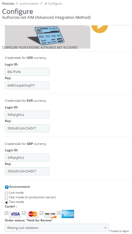

We migrated a prestashop multi-store jointsystems.us which went surprisingly smoothly with the exception of one module authorize aim 2.0 by DH had to be uninstalled to install update.  Upon completion when testing front end for purchase, after clicking on product add to cart there is no response.  In the configuration details there is one note though the auto updater says all files are up to date?

When you click on an item to add to cart there is no response.  No pop up.  In an other migrated shop the cart does popup bt when you get to payment there is no credit card choice, though authorize aim is configured with all cards checked marked?

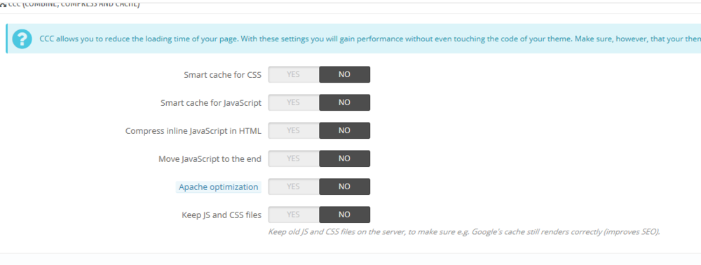

Could you disable the smart cache for javascript and some other optimizations in Advanced settings->Performance?
There are some javascript errors and with the optimizations it is not possible to determine which files cause them.
In addition you might consider switching off pretty urls.

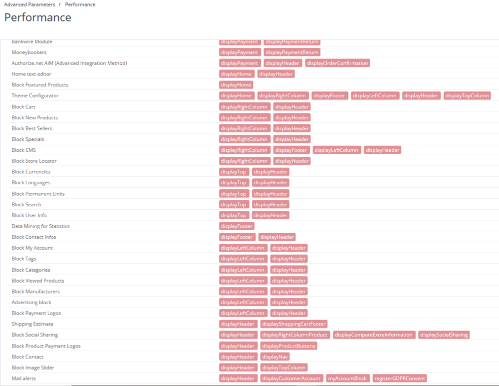

Turned off cache, did not know what to do with the other boxes so I turned them off too.   Strangely the modules list at the bottom of this page are all highlighted in red?
I am not sure what you mean with "the modules list at the bottom of this page are all highlighted in red? "

Both ups and fedex are configured and online.  In shipping carriers  there are about 20 options for ups and fedex delivery?
Yes it is installed and configured.  One strange thing though is at the bottom of the config it says waiting for cod validation.  When I change it to shipped or payment error and save it, it does not change?

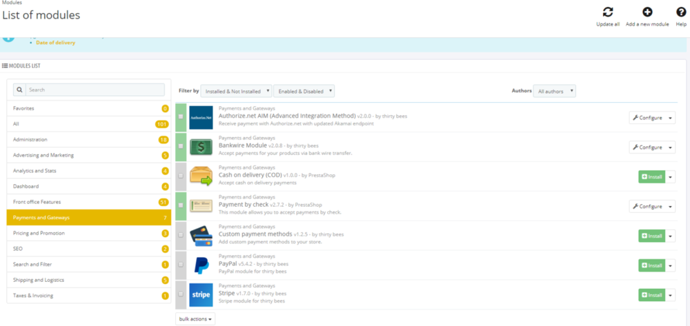

First of all - after the migration all duplicate modules by PS are still there. You should go through one by one and uninstall and reinstall the TB ones.
If you have done this and you have no problems other than the missing images and missing payments by card you are ready to proceed.

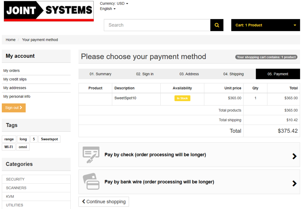

For the missing payments - do you have all the proper settings in Modules -> Payments. All currencies supported and all groups should be enabled for the selected payment module to show when needed.
Regenerated the thumbnail images.  Uninstalled the prestashop modules if a TB module was available.  "   Only have bank wire, authorize net and check payment modules installed.  The only one that is prestashop is the check as there was no TB module.

Still Card processing does not show up.  Have reset and  authoize net multiple times.
