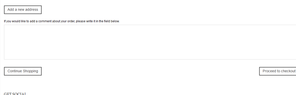

colorful-ant Posted July 19, 2019 Posted July 19, 2019 (edited) Thanks Petr. The new version is great. I did not read all the comments. - Is the module compatible with other themes such as Panda? - An input field in the order process is still missing or I have overlooked it: "If you would like to add a comment about your order, please write it in the field below." example Edited July 19, 2019 by colorful-ant

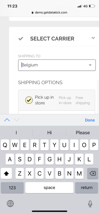

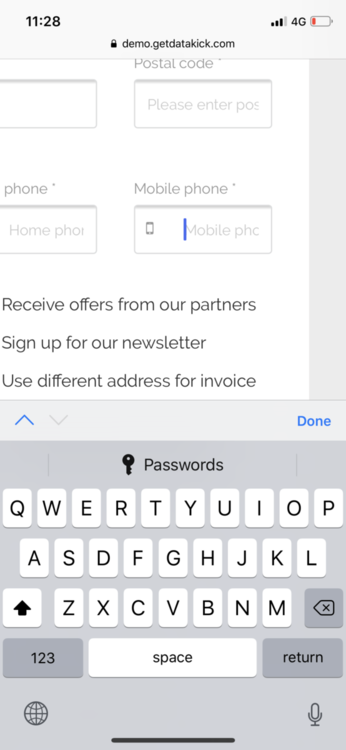

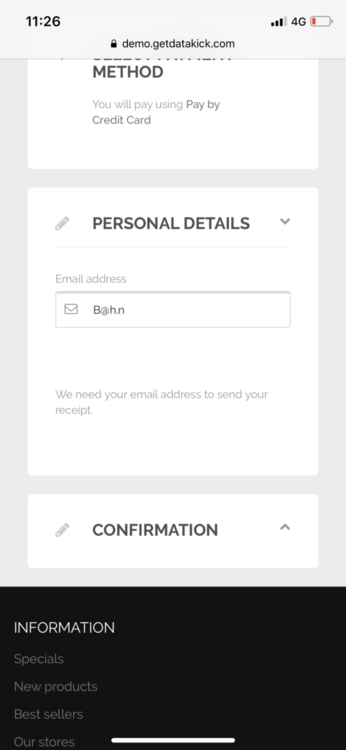

MockoB Posted July 22, 2019 Posted July 22, 2019 (edited) Hi @datakick first of all your module is just great, as all your job. I think I wrote you once on email about such behaviour on your site and I just noticed it on the module’s demo. It’s about the zoom when selecting input field on safari (iPhone). I don’t know if it is same on android devices. But it really is not providing best ux, if I have to zoom out every time when I select an input field, and It would be great to fix it. Here are some screenshots: Other thing I noticed is when I enter not complete email address, there is no error message or anything informing me that I should enter complete email to continue. i am attaching screenshot of that also. Edit: It would be great if the phone number input fields for example, bring the large numeric keypad on mobile, instead the normal (letter) keyboard. Edited July 22, 2019 by MockoB
datakick Posted July 22, 2019 Author Posted July 22, 2019 I've just released new version 0.3.0. This version adds some new functionality, but more importantly it fixes serious login-related bug introduced in 0.2.0. I strongly suggest you to update to this new version NEW FUNCTIONALITY Support for manual exemption in VAT module. Your customers can now click I qualify for VAT relief checkbox Added password reset functionality Added floating UI notification snackbar to inform user about various events (invalid password, wrong discount coupon code,...) BUGFIXES Fixed serious bug regarding login user Fixed bug with not showing all customers addresses 1
