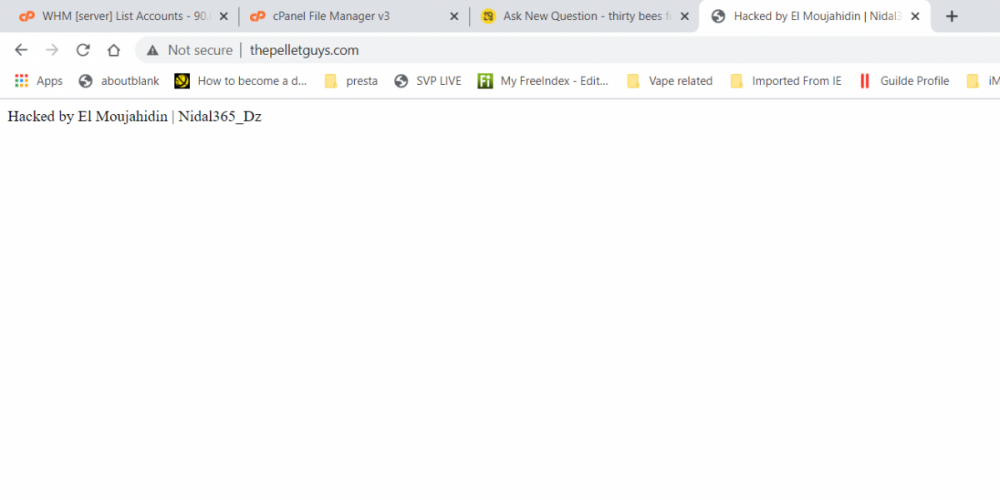

As the title  we had some weird stuff going on yesterday  a 63gig error log filling up the SSD  alerted me to it and i seemed to spend all day fixing and chasing problems only to be greated with this (SEE SCREENSHOT) at 3.15pm GMT
I have a sneaky feeling  the host has problems as over the last 12 hrs things seem to be shutting down there end  client protal access  has gone and a few other things,  all my company websites  are on that dedicated server and all hacked with the same front page.
I just don't know where to start, im reasonably good with moving files around but wouldnt know what files should or should not be on the server
Is there anyone on here that can offer me a little advice I have packed up and downloaded my entire Home directory as a start  from WHM  in case someone decides to delete all the graft i have put in and im downloading the databases now

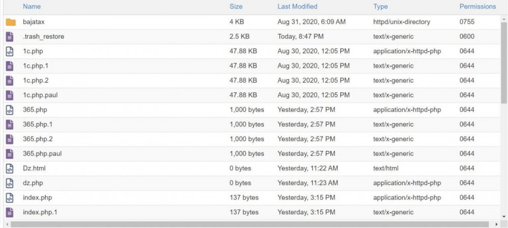

I think i found one of the issues somehow the hacker has uploaded a folder called bajatax via one of my Presta sites the day the problem started it looks like it was uploaded via a prestashop module,  they just defaced everything a couple of hours after this was installed,  now to find out what module they used  I found a lot of php files installed the same time
Could you archive somewhere affected files? Im interested in finding a way and more in how/what their code can do to TB...
I could zip these up and put them into a dropbox folder  not sure how safe that is

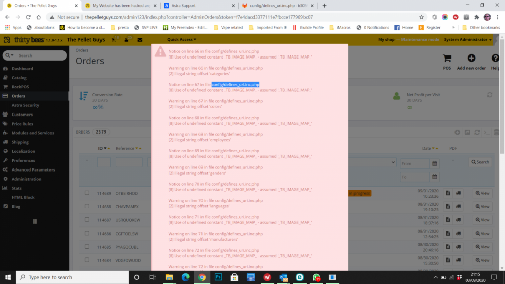

My Bees site has gone wrong again all the prices vanished at around 12.30 BST  today  looks like I still have a rogue script doing some damage in the background,  I tried the core updater and this time i wasnt so lucky  so back to maintanence mode while I dig through it all again, whats strange this time is all the prices of the products appear and are correct when i open the back office products tab,  it just isnt transferring to the front end and there is no option to add to cart,  its almost as if the site is in catalogue mode  although that feature is clearly off
Im also not getting any errors in debug mode
Anyone have any clues?

I mentioned before that all the prices are missing from the website, so I made a test product followed the same route as before and no prices are visable,  I have checked and re checked show prices, turn off catalogue mode etc etc  and still no prices. please note all the prices are still intact and correct from the individual products page  and the master products page
My question is  would this be a database  issue?  (my concern of course is im trying to avoid a total rebuild)  and if yes using a fresh set of files with the old database would result in the same issue  or is this more likely to be a core file thats been over written and if so which one,  I have used the core updater a couple of times to replace changed files  and it fixed the issue first time round but not this time.
I can't help thinking Im somehow locked in Catalogue mode
