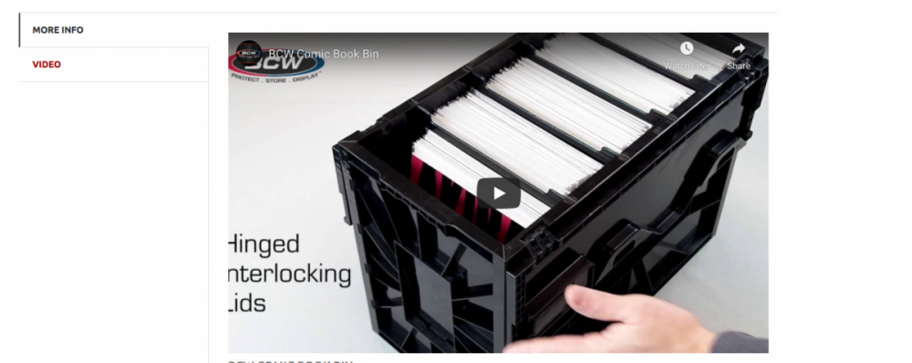

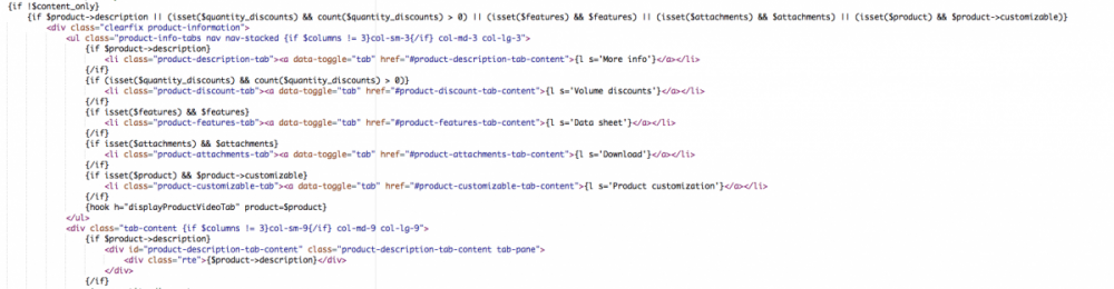

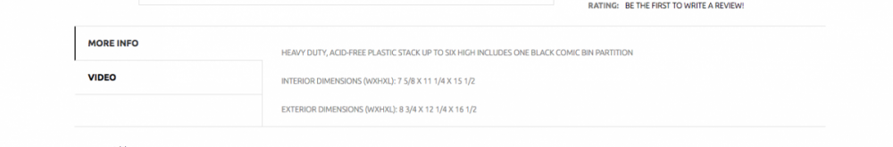

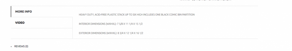

movieseals Posted February 1, 2021 Posted February 1, 2021 I did. My changes appear for a few seconds then they revert back... Then I found where I could at least change the buttons style in entity-review-list.tpl. I changed it from primary to default, which has the correct stylings. But again, the change appears then flashes away a few seconds later to revert to the old style. Also, no matter what I try, the tab will not match the other tabs of the theme, it is just a weird bland dot with the text reviews. Normally, tabs in my theme should look like this: Normally, there should be a third tab with REVIEWS. But instead, this is what I get: I have tried to copy and apply the stylings, to no avail. It looks like there is a hook for the video, wondering if I do not need to create a hook for reviews too (from product.tpl): And I am trying to turn this (BE THE FIRST TO WRITE A REVIEW LINK): Into a button and I cannot figure out where to do it for the life of me. I am not an expert but usually I can navigate those stylings issues. I really like the module and want to buy the full version but I need to find a way to better integrate it.

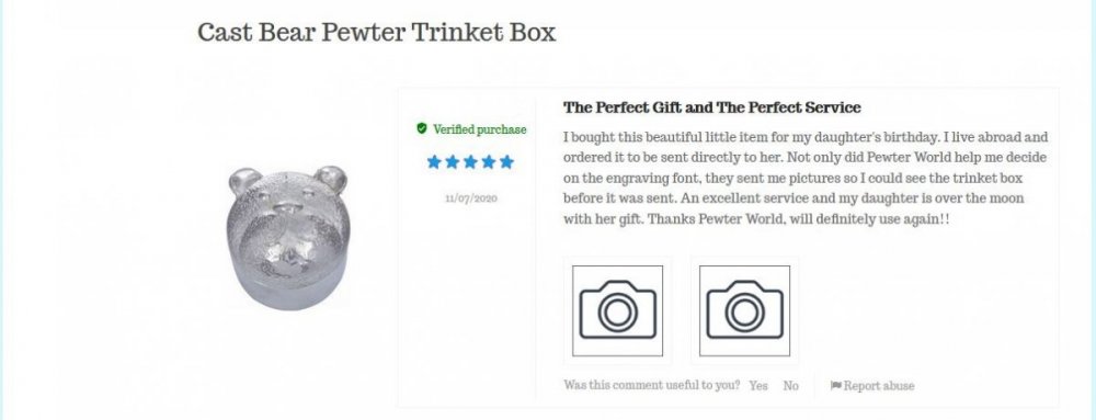

AndyC Posted August 2, 2021 Posted August 2, 2021 Hi. Here is the review left by someone.. Is there a way to remove/ hide the 2 blank images..As you can see the images are missing.. It' not a issue really ,just looks untidy
datakick Posted August 2, 2021 Author Posted August 2, 2021 16 minutes ago, AndyC said: Hi. Here is the review left by someone.. Is there a way to remove/ hide the 2 blank images..As you can see the images are missing.. It' not a issue really ,just looks untidy I see. Unfortunately no, it's not possible from within the module itself. You can delete it directly in db, using query like this: delete from tb_revws_review_image where id_review = 12345; Just replace id_review with correct value
