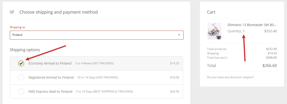

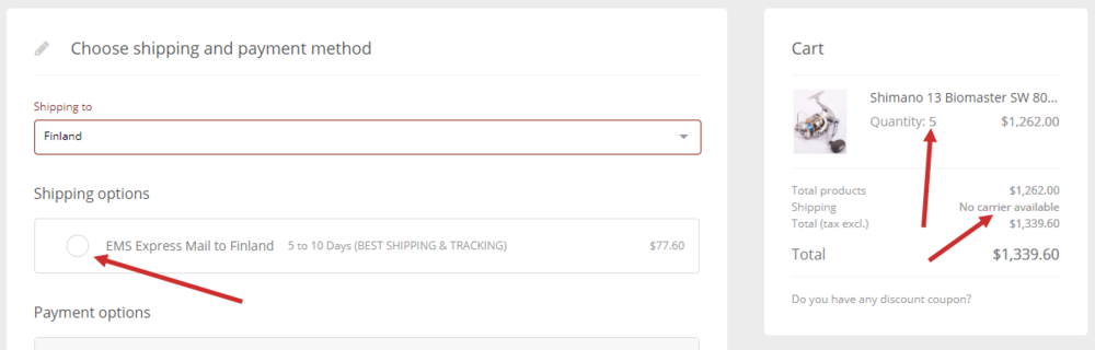

dynambee Posted October 11, 2019 Posted October 11, 2019 (edited) I may have found a couple of bugs. Testing Chex 0.6.1 on TB 1.1.0 "bleeding edge" with Panda 1.5.0. I have disabled uninstalled my custom shipping modules to make sure they are not the cause of these issues. This may be related to the Panda theme, but when I change item quantities on the Chex checkout screen the total cart quantity shown on the shopping basket in the top-right of the screen does not update. Likewise the total cart value displayed next to the shopping basket in the top right corner of the screen does not update. When I increase the quantities of items in the cart if the weight exceeds the maximum for a given shipping carrier that carrier is removed when I click on "Done". Perfect, this is what is supposed to happen. Unfortunately when I decrease the quantity of items to the point that those other carriers should now be usable they do not reappear. Actually the first time I decrease the quantity (and therefore the total weight) and click on "Done" the carrier options do not appear even if the total cart weight should allow them. However if I change the quantity a second time to a different quantity (either higher or lower) that should allow those carriers then they reappear. And two (hopefully somewhat minor) feature requests: When the cart contents are displayed on the top of the checkout usually the name of each item in the cart can be displayed in full as there is lots of space. However when the cart is shown on the left side or the right side there isn't enough space and item names are often cut off, making it difficult for customers to tell exactly which items are in the shopping cart. As an example, I sell an item called a "Shimano 13 Biomaster SW 8000HG Saltwater Spinning Reel" and a different item called a "Shimano 13 Biomaster SW 8000PG Saltwater Spinning Reel" but in the cart both are shown as "Shimano 13 Biomaster SW 800...". It would be fantastic if hovering over the item name caused a tooltip to appear displaying the full product name. The small cart list in Panda does this and it's great: Also as can be seen in the small Panda cart list above, there is a little x to remove the item from the cart. Right now with Chex a customer has to decrease the quantity to 0 and then click "Done" to remove the item from the cart. While I would sooner that customers never take items out of their carts, they are going to do this sometimes and having a little x mark or a mini trashcan icon to make this a bit more intuitive for customers would be a nice touch, IMO. Edited October 11, 2019 by dynambee As noted.
dynambee Posted October 11, 2019 Posted October 11, 2019 (edited) Oops, and I found one more potential bug: When the cart is edited and the quantity of items is increased to the point that the currently selected shipping carrier is no longer available (cart is too heavy), the selected shipping carrier is removed when "Done" is clicked. That's exactly what should happen, as described above as well. The problem is that when the currently selected shipping carrier is removed, no shipping carrier is selected at all. When this happens a message appears in the cart summary (Shipping line) that says, "No carrier available". However there is a carrier (or many carriers) available, it just wasn't automatically selected by the cart when the other carriers were removed.So I suggest that after a cart update is done if there is no carrier selected that the first carrier in the list of available carriers should be auto-selected by the cart to avoid the "No carrier available" message. Starts with this: Then when I increase the quantity (and therefore weight) to make Economy Airmail disappear, this happens: Edited October 11, 2019 by dynambee Duplicate images.

dynambee Posted October 13, 2019 Posted October 13, 2019 On 10/11/2019 at 8:10 PM, dynambee said: When I increase the quantities of items in the cart if the weight exceeds the maximum for a given shipping carrier that carrier is removed when I click on "Done". Perfect, this is what is supposed to happen. Unfortunately when I decrease the quantity of items to the point that those other carriers should now be usable they do not reappear. Actually the first time I decrease the quantity (and therefore the total weight) and click on "Done" the carrier options do not appear even if the total cart weight should allow them. However if I change the quantity a second time to a different quantity (either higher or lower) that should allow those carriers then they reappear. Expand On 10/12/2019 at 6:24 AM, datakick said: I can't reproduce this. This works ok for me. You can have a look at this video Expand I have reproduced it as follows: I created a brand new test store, fresh install of 1.1.0, ran core updater to 1.1.x Bleeding Edge. Installed Chex 0.6.2 trial version. Did not make any changes to Chex or use any custom CSS. Standard Niara theme No modules added besides Chex. No customization done to TB or Niara. Basic settings like enabling SSL and disabling sales taxes. Deleted existing zones and created a new zone for United States. Made sure the United States country & states are properly set to the United States Zone. (This emulates the way I set up my other store.) Created three carriers. First two (Economy and Registered) are for up to 2000g. Third (Express) is for up to 8000g Created test item with weight of 767g (same weight as my item had in the previous store). 1 item or 2 items in the cart should allow all three carriers but 3 items or more should allow only the Express Mail carrier. Once I had things set up I ran the same sort of test as I did before, and here are the results (may need to select 1080p for clear video): I will PM you the site access details so you can have a look and try things out yourself. You're more than welcome to make any changes to the site and generally use it for testing purposes, it is not a site that I have any need for beyond testing this particular problem, and I have a backup of it anyway.

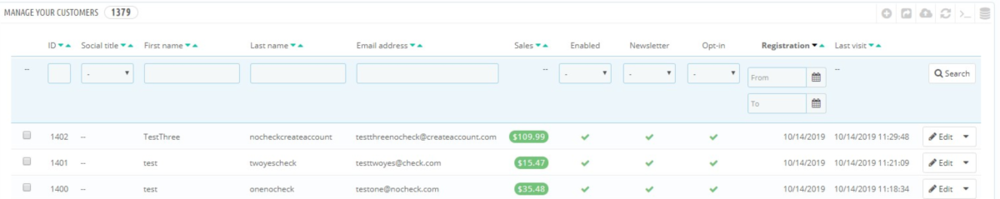

x97wehner Posted October 14, 2019 Posted October 14, 2019 @datakick Think I found a bug. When new customer creates an order, they do not select the opt in or newsletter boxes. After order is processed, in back office, both opt-in and newsletter boxes are checked. Tested while creating account and using guest checkout. 1
dynambee Posted October 15, 2019 Posted October 15, 2019 (edited) I've installed the just-released 0.6.3 and it seems to be operating as expected. So far I have not discovered any additional issues. @x97wehner, one of the bug fixes is what you reported, and the CSS IDs are there for the totals too. Huge thanks to @datakick for such an impressive checkout module! Bug fixes: Quote Fixed bug with displaying incorrect carrier list in some corner cases Added HTML IDs for elements in cart (tax, total, discounts,...) in order to easily target them by CSS rules Fixed saving Newsletter / Opt In preferences Expand Edited October 15, 2019 by dynambee 1
